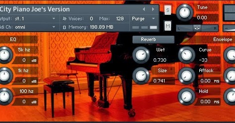

I also like the independence from the PC. For a long time I'm looking for a piece of hardware to play my own sound files (SF2) without a PC. I don't seem to be the only one looking for something like this. Now that I wanted to know how powerful the Axoloti is, I searched for samples for a piano under this link:
The City Piano is a fully sampled Baldwin Baby Grand with 4 velocity layers and release samples. It is free and public domain. Do anything you like with it.
http://www.mediafire.com/download/4vmjle2acsy1xd2/City_Piano_Close_Samples.zip
