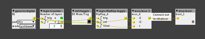

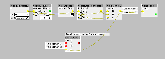

Hey @donaldhamby
Check this patch. It is extracted from a controller patch for the "Modular Thing Add on board" that I made a while ago. The original patch is in the link. This specific patch only consist of one button. You can switch between toggle and momentary mode. Try it out, I think it will work:
Toggle.axp (2.1 KB)

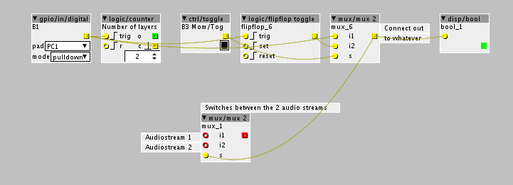

Hi,
Thank you for the suggestion, but how do I apply that patch to two audio streams?
Sorry, I'm still new to this!
