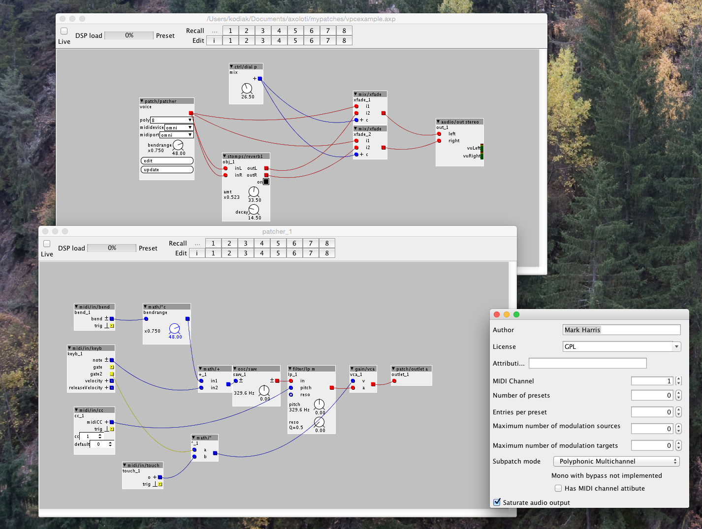

#3
ok, just check, and its working as expected, i.e. you do not need attribute.
here is a simple working example
(you'll note I use patch/patcher so I can embed the voice in the patch... makes editing much easier... but it works identically to subpatches... i.e. this is not the reason it works)
vpcexample.axp (7.4 KB)
notes:
  • this is voice per channel (note mpe, which has explicit support in midi/ctrl/mpe) (see library/demos/synth/mpe/simple for an example of mpe)
  • uses MW (CC 1) for timbre/Y , PB for X and channel pressure for Z ... this can easily be changed
  • pitchbend range is defaulted to 48, but you can increase up to 64,
    above 64 you have to take a slightly different approach due to dials only going to 64. (you would also want to probably use the continuums hi-res X cc, to avoid stepping)
(oops, screenshot shows voice named patcher_1, because i forgot to reopen it after renaming it to voice in the main patch, sorry for any confusion)
