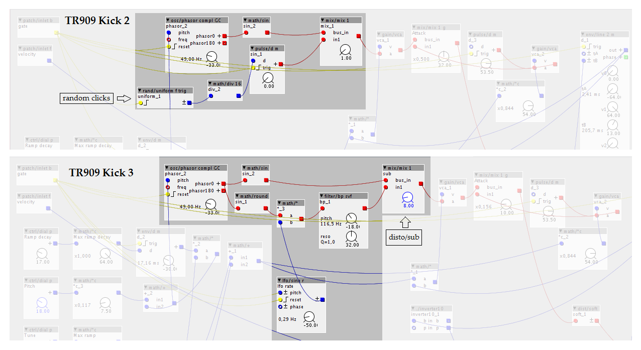

#9
Looks like nice ideas, I'll check them out later. Thanks for these!
